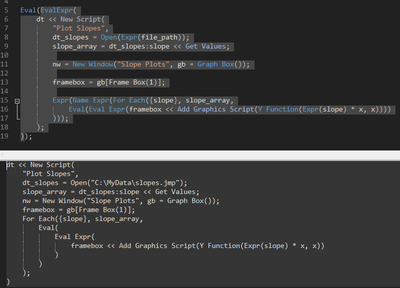

One option is to add some Expr(Name Expr()) to your code
Names Default To Here(1);
file_path = "C:\MyData\slopes.jmp";
Eval(EvalExpr(
	dt << New Script(
		"Plot Slopes",
		dt_slopes = Open(Expr(file_path));
		slope_array = dt_slopes:slope << Get Values;
		nw = New Window("Slope Plots", gb = Graph Box());
		framebox = gb[Frame Box(1)];
		Expr(Name Expr(For Each({slope}, slope_array,
			Eval(Eval Expr(framebox << Add Graphics Script(Y Function(Expr(slope) * x, x))))
When you run only the EvalExpr part you will end up with following script
dt << New Script(
	"Plot Slopes",
	dt_slopes = Open("C:\MyData\slopes.jmp");
		Eval(
			Eval Expr(
-Jarmo
dt << New Script(
	"Plot Slopes",
		Eval(
			Eval Expr(
-Jarmo
