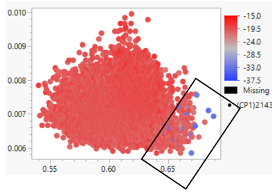

Hi pals,
I want to choose the points which are associated with two factors.
How can I select them as below graph marked in rectangle region?

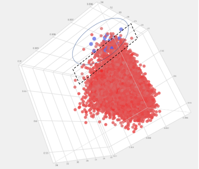

Furthermore, if they are associated with three factors, how can I select them?
In below graph, how to "slice" as black rectangle, so I can select the points in blue circle?

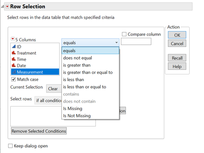

If you look into 3 dimensional space, that I would suggest to select your points on the table level using your factors:
Go to Rows -> Row Selection -> Select Where
Here you can specify what should be selected based on your columns, ranges and even conditions.
Hope that helps.

In graph builder you could maybe use lasso tool jthi_0-1708332892020.png or data filter (you might have to use Global data filter as local data filter is missing Select more unless you script it (I will make wish list item about this if there isn't one).
Names Default To Here(1);
dt = Open("$SAMPLE_DATA/Semiconductor Capability.jmp");
spd = dt << Scatterplot 3D(
	Y(:NPN1, :PNP1, :PNP2),
	Biplot Rays(0),
	Rotated Components("PC", "ONE", 0, "Varimax"),
	Frame3D(
		Set Graph Size(840, 711),
		Set Grab Handles(0),
		Set Rotation(-163.461667183383, -43.9054573632267, 88.2668787791015)
	Local Data Filter(
		Conditional,
		Mode(Show(0), Include(0), Select(1)),
		Add Filter(
			columns(:NPN1, :PNP1, :PNP2),
			Where(:NPN1 >= 108.673 & :NPN1 <= 114.197)
