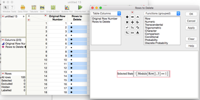

2) You could create a Row State column with a formula using the Selected State function to select every 2nd and 3rd row.
Notice that in the Rows to Delete column every 2nd and 3rd row is selected. I did this with the Modulo() function.
Now right click on the star next to the Rows to Delete column and choose Copy to Row States to select those rows in the active row state area. Now you can choose Rows -> Delete Rows.
