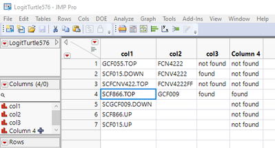

Here is one way to approach this, using a column formula.  Create a Character column and then paste this into the formula for the column.
x = "not found";
For( i = 1, i <= N Rows( Current Data Table() ), i++,
	If( Contains( :col1[i], :col2[Row()] ),
		x = "found";
		Break();
x;
Please note, your sample data table's entry for row 2 is incorrect.  FCNV4222 is not found in any of the rows for co1.  Row 3 value contains FCNV422 but does not contain FCNV4222

Many thanks for your quick reply.
Note : you are right. My example was not completely correct.
