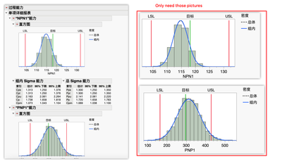

Hi, JMPer I want to use jsl to only save the Process Capability's histogram charts without any . Is there any way to achieve it?
6 REPLIES 6
jthi
Re: How to save picture by jsl
If you just want those histograms and nothing else, it is most likely easiest to capture them one by one from distribution platform

Those images can be captured from Process Capability or from distribution when you have all of those open at the same time, but it is easier to navigate report layer this way.

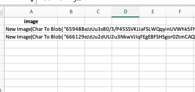

But I had another question, after saving image to table, can export as excel file? I tried to do this, it was not shown as picture.
peng_liu
Staff
This not possible to my knowledge. Here are the reasons:
1) Images in Excel are not cell data. They are OLE objects, which you can think that images are attachments to the sheet. Images in JMP Data Table are cell data. So Excel and JMP see images differently.
2) Excel probably will never understand the meaning of images in JMP.
