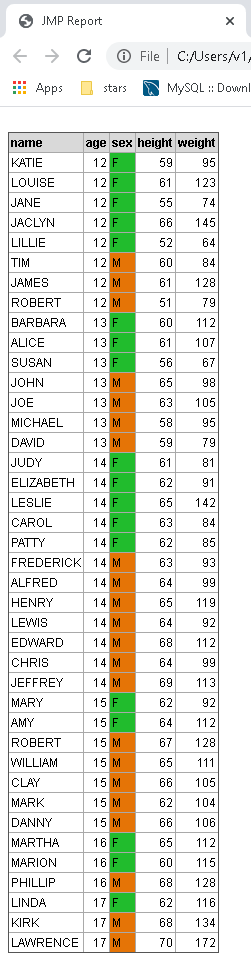

Craige_Hales
Re: How to save data table(colored cells) to Interactive HTML?
Jim's approach captures a picture. Try this to have an HTML table with selectable data:
dt=Open("$SAMPLE_DATA/big class.jmp");
dt:sex << color Cells("green",dt<<get rows where(:sex=="F"));
dt:sex << color Cells("Orange",dt<<get rows where(:sex=="M"));
temp=new window("temp",<<journal);
dt<<journal;
temp<<saveHTML("$desktop/bigclass.html");
temp<<closewindow;
big class in  browserbig class in browser
Craige
Botzal
Level III
Thank you very much, it works great!
