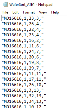

Hello....I'm trying to save off column entries to text file without column name. These text files are used by VB code in another existing program that expects the fields in each line to be separated by commas. I'm able to get the text files created without the column name (thanks to another user's previous post!) but I can't get the code to not put quotes around the entries for each line. I've tried several options in "End of Field", but all still adding quotes. I know if I change the delimiter in each line to be something other than comma (ex. ".") then I can get the JSL code to not add the quotes, but the external VB code is expected "," delimiter and difficult to change as it is legacy code used by many. Any ideas how to keep out the quotes while still maintaining the comma delimiter in each line? I could of course remove them in editor, but there can be many of these txt files generated. JMP ver 16.2, Win10.
Example:
I need it like this:
MD16616,1,23,3,
MD16616,1,26,4,
MD16616,1,22,4,
MD16616,1,23,4,
MD16616,1,16,2,
MD16616,1,11,6,
MD16616,1,24,7,

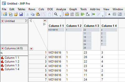

How does your data table look like? Something like this?

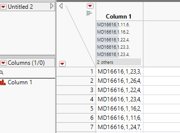

or like this?
One option would be to build a string and then save that using save text file().

Data table in JMP looks like the 2nd you showed. Your solution works perfectly. Thanks very much! And duly noted on the preferences change...hadn't thought about crash scenario.
