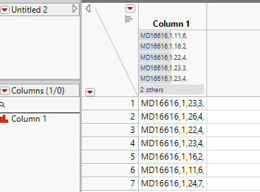

How does your data table look like? Something like this?

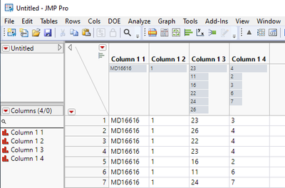

or like this?

Data table in JMP looks like the 2nd you showed. Your solution works perfectly. Thanks very much! And duly noted on the preferences change...hadn't thought about crash scenario.
