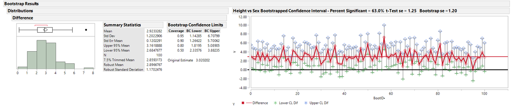

Attached is a script written for Chapter 9 of JSL Companion, 2nd Edition.  It demonstrates:
  • a bootstrap of a 2 sample t-test from a Oneway analysis (only 100 was chosen)
  • how to get the results
  • how to plot the results
  • as an extra is shows how to order customizations by sending clicks to the customize framebox window.
