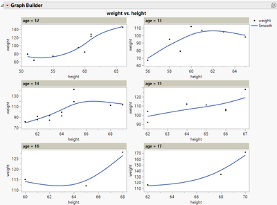

This is from the big class data set:

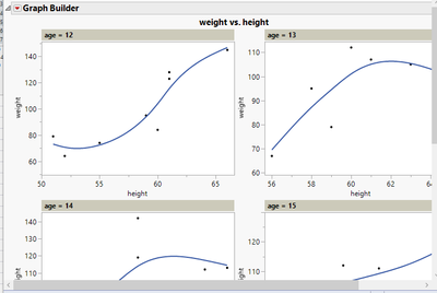

If I wanted to set the size to be much bigger using JSL (the auto fit window is turned off) to something like this:
how would I accomplish that?

Names Default To Here(1);
nw = New Window("",
gb = dt << Graph Builder(
Size(569, 357),
Show Control Panel(0),
Replicate Linked Page Axes(0),
Fit to Window("Off"),
Variables(X(:height), Y(:weight), Page(:age, Levels per Row(3))),
Elements(Points(X, Y, Legend(91)), Smoother(X, Y, Legend(92)))
ldf = gb << Local Data Filter(
Add Filter(
columns(:age),
Where(:age == {12, 13, 14, 15, 16, 17}),
Display(:age, N Items(6))
f = Function({a},
fbs = Report(gb) << XPath("//FrameBox");
fbs << Frame Size(300, 300);
rs = ldf << Make Filter Change Handler(f);
You might want to want to add some sort of "size forcing" to the graph builder/your window so the window won't keep resizing.
that graph builder doesn't update the size of the charts until I change the filter options. Is there a way to force the chart to update the size without the filter needing to be changed?
