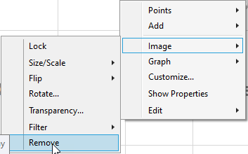

Manually, you could remove the image via the right click menu: Image/Remove

I had overlooked this.  Interesting that the log doesn't capture anything when you remove the image this way.
