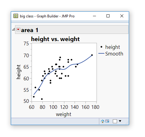

Hi,
I want to append  a report file with a graph. When I save it as a pdf it has the graph but the grey box saying graph builder. I want to change this to a different label - for example "graph of area 1". Is it possible to do this? I know you can do it from the report and save it but I can't seem to find jsl code that does this.

Craige_Hales
Re: How to remove graph builder label
dt = Open( "$sample_data/big class.jmp" );
gb = dt << Graph Builder(
  Size( 518, 448 ),
  Show Control Panel( 0 ),
  Variables( X( :weight ), Y( :height ) ),
  Elements( Points( X, Y, Legend( 6 ) ), Smoother( X, Y, Legend( 7 ) ) )
gb << showtitle( 1 );
gb << title( "area 1" );
Graph Builder sets the outline titleGraph Builder sets the outline title
<<showTitle(0) turns off the Height vs Weight text.
Craige

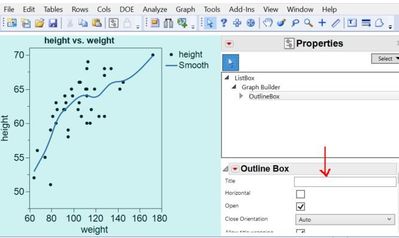

Santo
Level I
If you are looking to remove the "Outline box" title, go to Edit > Properties and manually delete the Outline Box title. Tricky to find but useful if you are saving your graphs as PDF. remove outline box title.JPGremove outline box title.JPG
