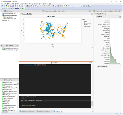

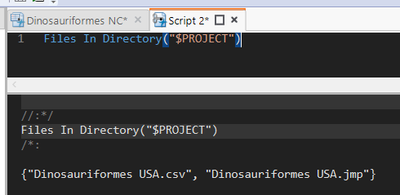

There is but it is only available inside a project, $PROJECT
Projects have their own a bit weird file "path: "jmpprj://contents/"
I think you can also use Get Default Directory() IF you have saved the script which is running that function inside the project.
Usually I try to script projects just like I would JMP normally (but in reality I try to JMP projects due to few issues they have), but depending where you are writing the JSL, inside or outside of project, it is a bit different.

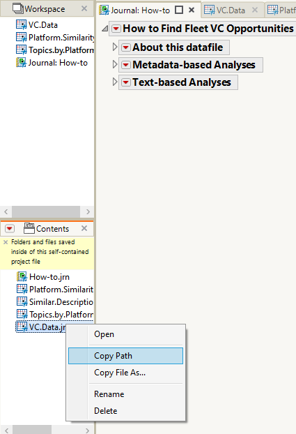

Well, accidentally discovered this while hovering over the project contents file list: right click on the file to copy the path...
