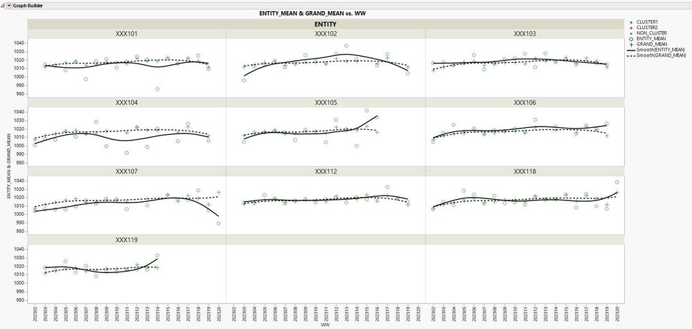

I have a piece of analysis (see below) where I want to annotate specific charts using a script I have written. For example, I want to add annotation to XXX104 and XXX107. On both of these charts I will add a custom graphic and text to identify a cluster of points I want to draw attention to.

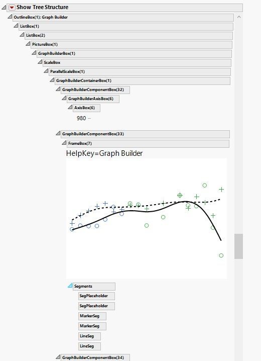

Using the command '<< show tree structure' I can identify the frameboxs which have each chart. However, I do not see the chart 'name' associated with them. For example, I want to be able to traverse this tree using the chart names (e.g. XXX107) as a lookup and identify the associated framebox (e.g. FrameBox(7)) so I can reference it and add my annotation in an automated fashion.
In fact in the entire tree I do not see any 'tree nodes' which have the 'chart names' such as XXX107

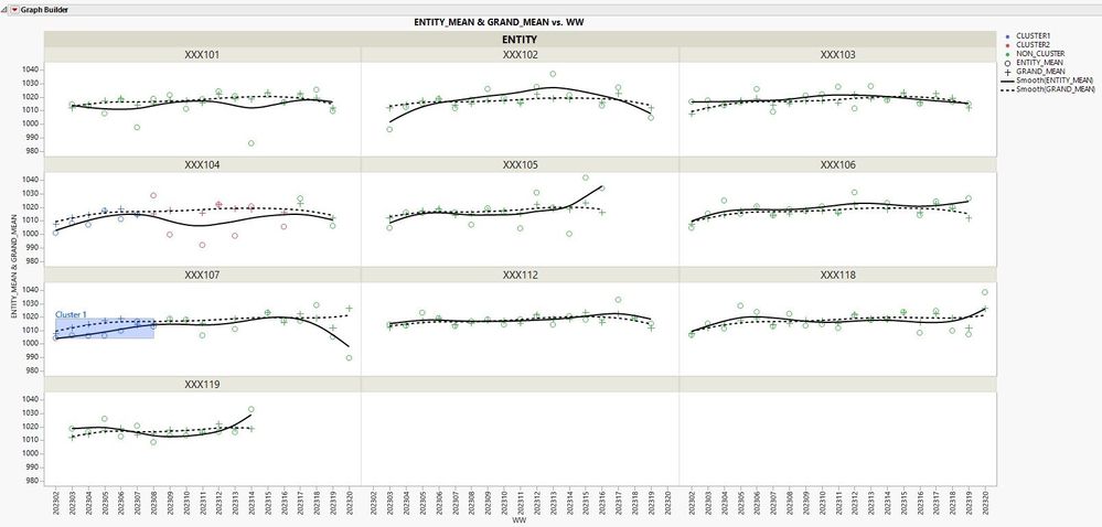

Ultimately the chart below is what I want to achieve
Here is the code which I used to do this manually. The file is also uploaded.

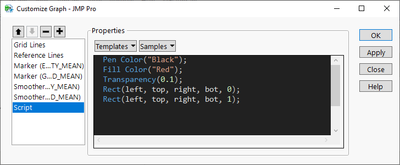

Eval(EvalExpr(
	fbs[fb_idx] << Add Graphics Script(
		Pen Color("Black");
		Fill Color("Red");
		Transparency(0.1);
		Rect(Expr(left), Expr(top), Expr(right), Expr(bot), 0);
		Rect(Expr(left), Expr(top), Expr(right), Expr(bot), 1);

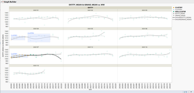

Also remember to evaluate the values into graphic script, so you won't end up with this.
In general GraphBuilderGroupBox are very difficult to access/manipulate and I would try to avoid it as much as possible. You can get the titles with XPath, but there can be extra titles
(Report(myGraphBox) << XPath("//GraphBuilderGroupBox/text()"))
