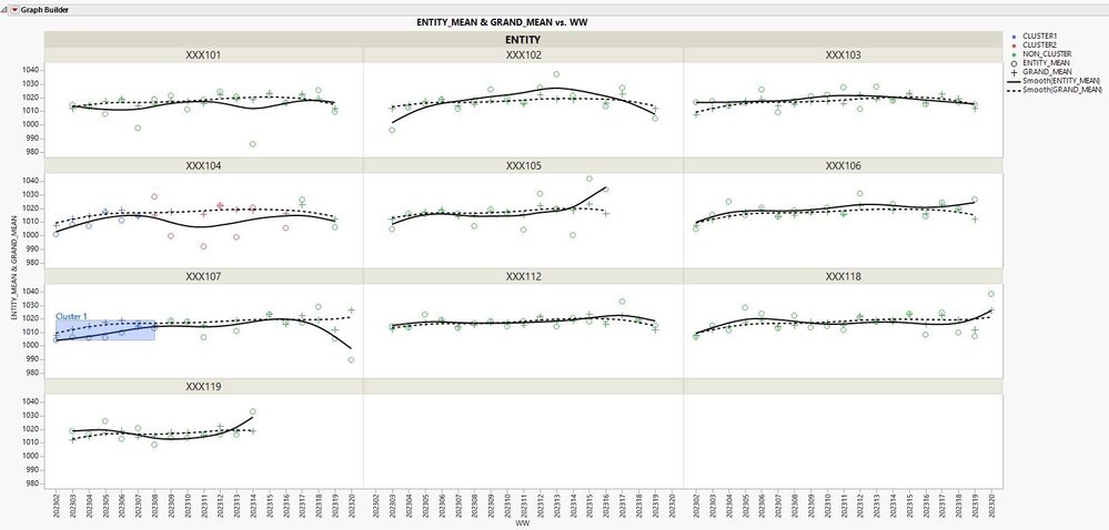

I have a piece of analysis (see below) where I want to annotate specific charts using a script I have written. For example, I want to add annotation to XXX104 and XXX107. On both of these charts I will add a custom graphic and text to identify a cluster of points I want to draw attention to.

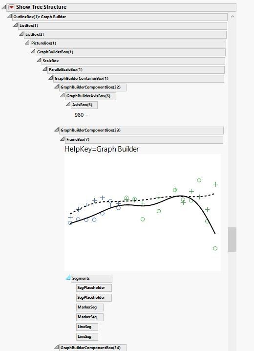

Using the command '<< show tree structure' I can identify the frameboxs which have each chart. However, I do not see the chart 'name' associated with them. For example, I want to be able to traverse this tree using the chart names (e.g. XXX107) as a lookup and identify the associated framebox (e.g. FrameBox(7)) so I can reference it and add my annotation in an automated fashion.
In fact in the entire tree I do not see any 'tree nodes' which have the 'chart names' such as XXX107
Ultimately the chart below is what I want to achieve

My issue is I cannot figure out how to reference a framebox by identifying it's corresponding 'title' in the display tree.
