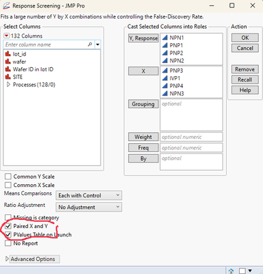

How I would approach this, is to use
     Analyze=>Screening=>Response Screening
This will allow you to select the pairwise analyses you want

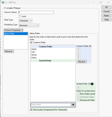

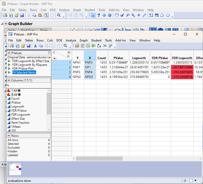

The platform creates a Pvalues table, which you can easily plot the pairs of X and Y columns using Graph Builder,. and specifying RSquare as the Color column.
The order can easily be changed by setting the Value Order column property
Which when the Apply button is pressed, the graph is changed to:

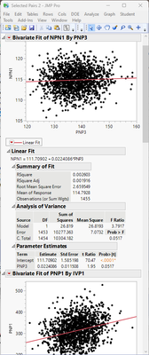

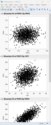

The Bivariate plots are also available.  By selecting 1, 2, ......n rows in the Pvalues data table, and then clicking on the embedded script, "Fit Selected Items"
A window will be displayed with all of the Bivariate plots within it.
The Fit Line, etc. can then be run.  By holding down the CNTL key as you select Fit Line or any of the other options, the selection will be run on all graphs.
