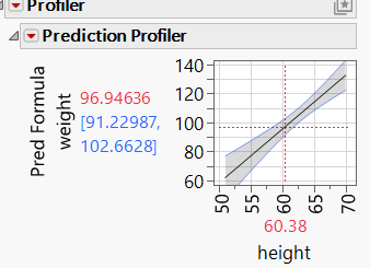

with JMP18, it got very easy:  the confidence intervals are saved as hidden columns - with a link to the prediction formula.
When you use the prediction fomula in the profiler, the confidence intervals are added automatically:

If you are using a version prior to version 18, save the prediction formula (as you have done) and then save the StdErr Pred Formula (make sure that it is the formula column). When you choose Graph > Profiler, put the prediction formula and the StdErr Pred Formula in as Y's. JMP will ask if it should use the Std. Err column to form the intervals or plot it separately. Answer YES, that it should be used for the intervals.
