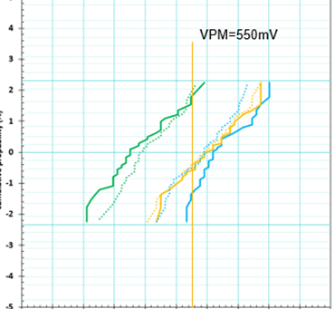

How to plot a graph with Y-Axis using Sigma?
the plot below Y-axis is by sigma, how to create a plot like this?

Re: How to plot a graph with Y-Axis using Sigma?
Please check this post.
https://community.jmp.com/t5/Discussions/how-to-make-cumulative-probability-plots-in-JMP/m-p/529725#...
Is this what you want?
just with interchanged x and y axis?
