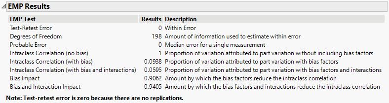

I think that the first set up is correct, but without replication, it is impossible to estimate repeatability. That situation leads to the warning message you got. Does your EMP Result look like this example:
If so, notice that ICC is reported three times. They are all correct but represent different answers to different questions. Is it possible that you have both rater bias and interaction with the components? If so, use the second or third ICC, not the first one.
