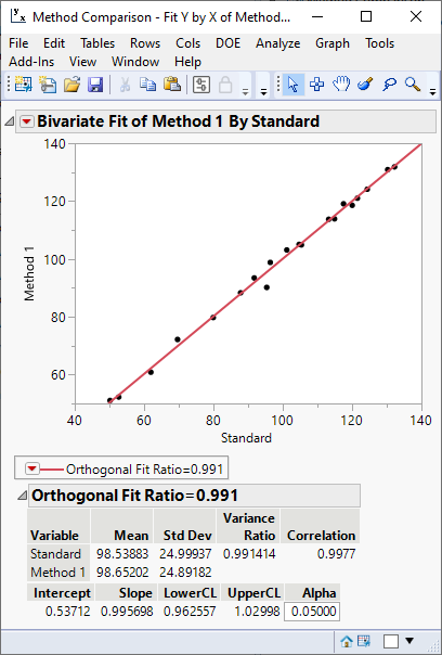

Re: How to perform equivalence test for the slope of fit line?
Method comparison often uses Deming regression to fit the line based on the matched pairs of observations. Try Analyze > Fit Y by X with test method in Y and reference method in X. Click OK and then click the red triangle and select Fit Orthogonal > Univariate Variances.
The confidence interval estimate of the slope includes 1 in this example, so there is insufficient evidence that the methods do not agree.
There will be more capability for method comparison in JMP 17.
