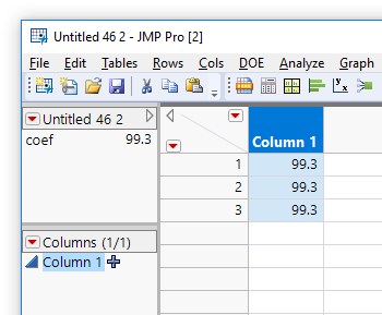

Craige_Hales
Re: How to pass a variable into a formula?
edit: after re-reading, this might not be the answer.
Use a Table Variable, by scripting, or from the red triangle.
New Table( "Untitled 46",
	Add Rows( 3 ),
	New Table Variable( "coef", 99.3 ),
	New Column( "Column 1",
		Numeric,
		"Continuous",
		Format( "Best", 12 ),
		Formula( :coef ),
		Set Selected
Table VariableTable Variable

Craige_Hales
You need something like this. When you change the Table Variable, the column updates.
Eval(
    Eval Expr(
        ARIMA Forecast(
            :age,
            40,
            ARIMA( 0, 1, 1, No Intercept( 1 ) ),
            {MA Coefficients( {Expr( :coef )} )},
            Row() - 9,
            Row() - 9
Using the same table variable idea, notice how the eval( eval expr( ... expr(:coef) ... ) ) works. expr(:coef) identifies a snippet of the formula that needs a substitution made by evaluating it. evalexpr(...) does the evaluation of all the bits identified with expr, and returns an expression that still needs to be evaluated. eval(...) does that. (I changed all the parameters to make it do something with bigclass...don't use mine! I'm not familiar with the ARIMA forecast functions, or if it should be used in a column formula like this. The scripting index example does not use a column formula.)
