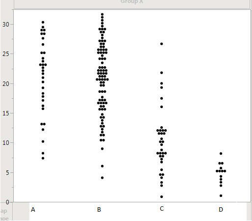

A quick question, as the title suggests, how can I overlay points with the same value or close values ( e.g., a difference smaller than 0.1) in a graph?
For example, in the following situtation I want to keep only one point for each small range of values, and therefore lose the observed horizontality of points.

In the control panel of graph builder, find the section that says Jitter and change the setting from Auto to None.

Thank you! :D
