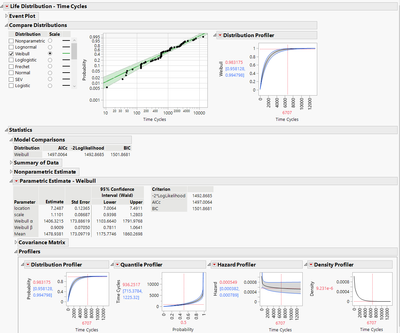

most of my cases are based on Weibull distribution. I would like to output the Weibull distribution probability of every point (i.e. Probability value of Time cycle from your plot) to the new data column via GUI.

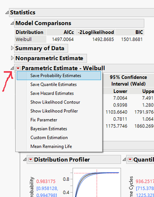

Re: How to output probability value from Life Distribution?
To output the distribution probability for every point, select the Red Triangle near "Parametric Estimate - Weibull" (or other distribution), then "Save Probability Estimates." This makes 3 new formula columns in the data table (the estimate and the upper & lower confidence limits).

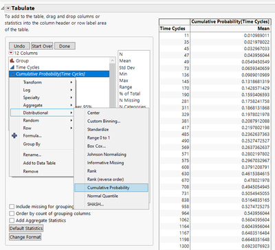

I'm not certain I'm following what you're looking for, but the method I showed previously does rely on assuming that a Weibull distribution (or whichever distribution you choose) fits the data. If you want a distribution-free output of the probability, this can be done in the Tabulate platform, using the Cumulative Probability formula in JMP. I've attached a sample data table with the script for this saved to the table.

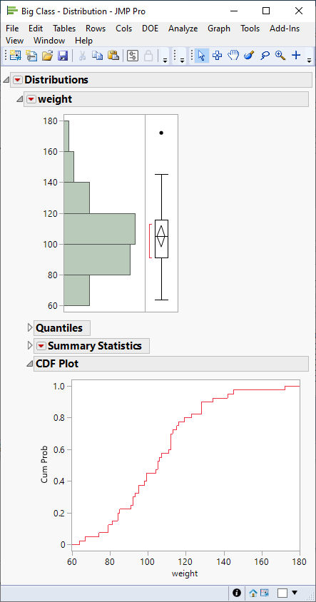

Do you want the probabilities from the empirical cumulative distribution function? If so, you can get them from Distribution. Here is the CDF Plot in Distribution:
Click the red triangle next to Weight and select Save > Prob Scores. A new column appears in the data table:
I confirm the empirical CDF by plot the new scores against the original variable, Weight:
