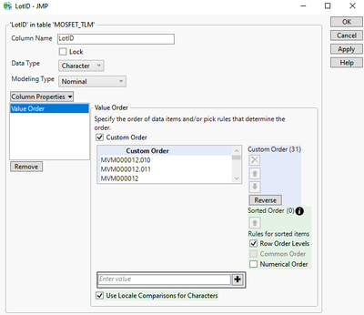

On my graphs I want the top most value(in the table) to be the furthest to the right on my plots. I have been right clicking then "Edit Value Order" to do this, but I would like to incorporate it in my JSL for my colleagues to be able to use as well.
I went into Scripting help but was lost as to how I would set Row Order Levels in JSL.

You can see how to set the different Column Properties by setting them interactively, and then using
     << get Property()
retrieve what is required to use
     << set Property()
to use JSL to assign the values

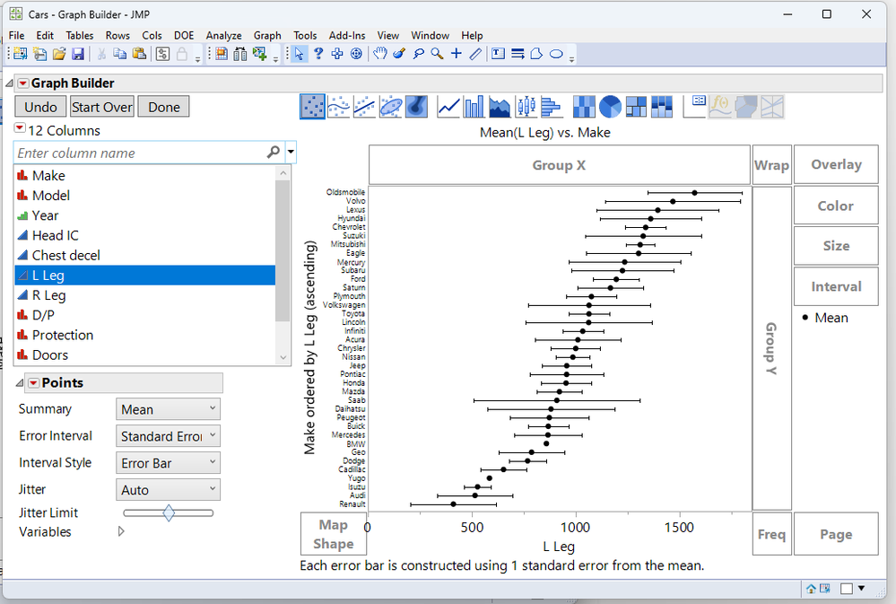

Hi @Hobbi ,
@txnelson gave you the exact correct answer.
Yet, the best ordering options for an axis in a graph are available in Graph builder. There, you can order a categorical axis by a variety of summary statistics of other variables. as in the pictures.
Let us know if it works in for your application.
