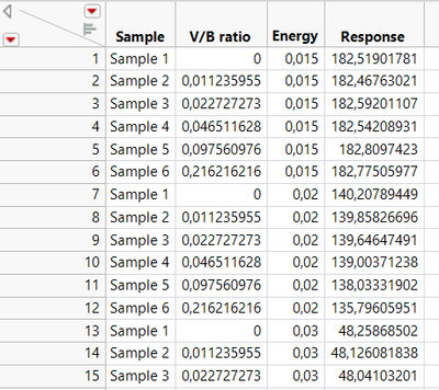

The attached file contains responses and the varied oxide ratios.

  • It may be easier to work with a stacked datatable for your data : one column for Sample ID, one column for ratio, one column for Energy levels and one column for Response to the energy levels by sample :

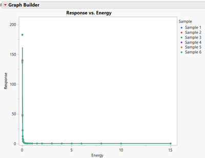

  • You can plot your data with Graph Builder, using Energy levels as X, the response as Y, and Sample ID as Overlay variable to get a better sense of the behaviour of your data/curves :
    The curves look very similar with an exponential shape, which leads me to the next point :

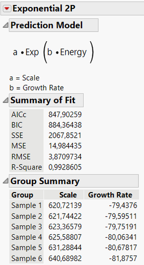

  • One possible way to deal with the curves data is to use the Fit Curve platform, with column Response as "Y, Response", Energy as "X, Regressor", Sample as "Group", and V/B Ratio as "Z, Supplementary". You can then model the curves using a model Exponential 2P, which gives you for each sample the Growth rate and scale parameters, according to this equation :
    Using these parameters in regression model as Y and V/B ratio as X could help understand the link between the shape of the curves and the V/B ratio :

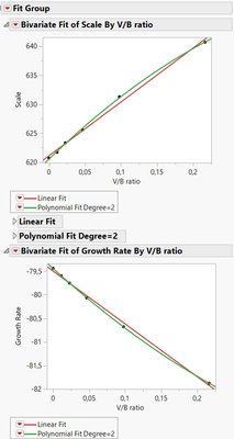

  • Using a table with the extracted parameters scale and growth rate from the previous analysis, and with the Platform Fit Y by X, you can link these two curves parameters to your V/B ratio factor. It looks like there is a linear trend between the curves parameters and the V/B ratio (a polynomial degree 2 equation might also work):

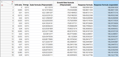

  • You can then use the equations linking these curve parameters to the V/B ratio in order to predict and modelize any curves in the range of the V/B ratio analyzed to create a prediction table :

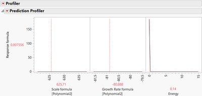

    This prediction table with "virtual samples" may help you "examine additional samples without actually manufacturing them in order to determine their response and, consequently, the best formulation to withstand the response". You can also use the Response formula and create a Profiler to better assess the changes in curves and values based on the scale and growth rate values :

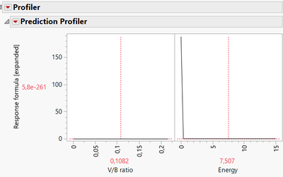

    Or expand the formula and integrate the equation of scale and growth rate directly in the formula to have the prediction profiler based only on V/B ratio :
