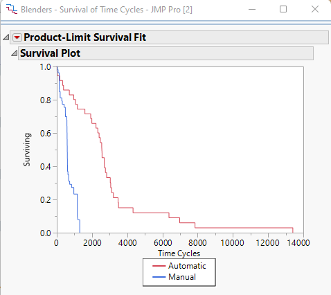

How to move legend in survival plot
Hi, how do you move the legend in a survival plot? Survival plots cannot be made, it seems using Graph Builder, so the normal menu command to move the legend into the plot is not available. JMP Pro v12.1.0.

By using the Display Tree capabilities within JMP, you can place the legend pretty much where you want to
Names Default To Here( 1 );
dt = Open( "$SAMPLE_DATA/Reliability/Blenders.jmp" );
su = Survival( Y( :Time Cycles ), Censor( :Censor ), Grouping( :Group ) );
pbox = Report( su )[Picture Box( 2 )] << get picture();
pbox = Report( su )[Picture Box( 2 )] << delete;
Report( su )[axisbox( 2 )] << append( pbox );
This was run in JMP 12

Re: How to move legend in survival plot
Did you know that you can click the red triangle and select Save Estimates? A new data table appears and you can now make plots in Graph Builder.
