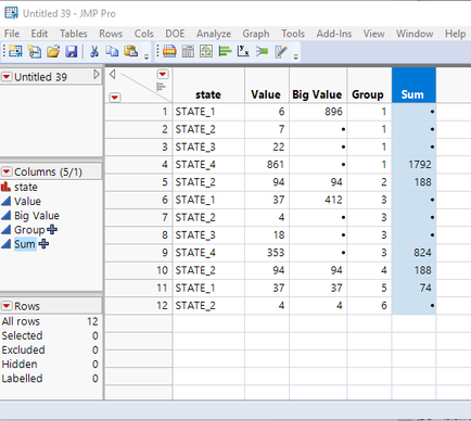

How can we merge rows of a table as shown below:
XY
STATE_1 1 STATE_1 6896
STATE_1 2 STATE_2 7
STATE_1 3 STATE_3 22
STATE_2 4 STATE_4 861
STATE_2 3 STATE_2 9494
STATE_3 2 STATE_1 37412
STATE_3 5 STATE_2 4
STATE_3 10 STATE_3 18
STATE_3 5 STATE_4 353
STATE_4 576 STATE_2 9494
STATE_4 33 STATE_1 3737
STATE_4 25 STATE_2 44
STATE_4 97
STATE_4 54
STATE_4 76
STATE_2 94
STATE_1 37
STATE_2 4
1. First group the continuous occurrence of rows
2. Calculate the sum of sequential occurrence of STATE_1 to STATE_4
Pfa the sample table for your reference

I solved the problem using 2 new formula columns
The Group column formula just creates a grouping number when :Big Value is detected
If( Row() == 1, theGroup = 0 );
If( Is Missing( :Big Value ) == 0,
	theGroup
theGroup;
The Sum column formula just looks one row ahead, and if it detects a non missing value for :Big Value, it adds up the sums for both :Value and :Big Value for the current Group and then adds them together
If( Is Missing( :Big Value[Row() + 1] ) == 0,
Sum( Col Sum( :Value, :Group ), Col Sum( :Big Value, :Group ) ),
If( Row() == N Rows( Current Data Table() ) & Is Missing( :Big Value ) == 0,
Sum( :Value, :Big Value )
Attached is the data table I used
Jim
