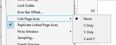

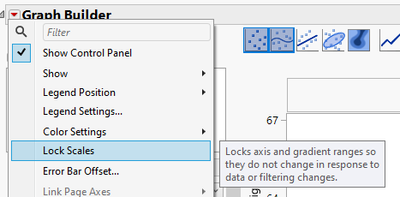

How should your data be displayed? In graph builder you have Lock Scalesjthi_0-1731696135339.png
and Link Page Axes
as some controls you could utilize. It could also be just and order of setting things issue (set isometric before any changes are done and they MIGHT copy first selection).
