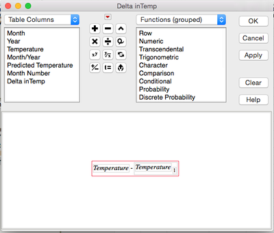

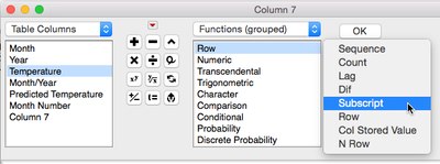

Re: How to make a formula (Delta / %Delta) in JMP
You use a subscript on a column reference to index into a specific row. In your case, row 1.8910_JMPScreenSnapz002.png
So the formula for Delta in Temp looks like this:
-Jeff
-Jeff

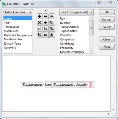

Jeff_Perkinson
I just realized that you were resetting your Delta at the beginning of every year. In this case you'll need to index your subscript based on the month in the current row. Like this:
-Jeff
