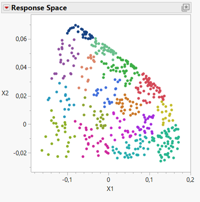

In attachment a data set with 500 combinations X1 and X2; 17 clustered in 17 categories.
How, with covariates X1 and X2, to generate a 5x17 = 85 run covariate DOE so that from each cluster/category 5 samples are selected?

It seems your clusters can be separated easily based on X1-X2 coordinates, and the number of samples per cluster can vary from 16 to 60, so maybe an adaptative sampling based only on the continuous coordinates would be sufficient. Looking at the plot of the cluster points in the X1-X2 experimental space, it reminds me of the clustering process behind the Fast Flexible algorithm (that I described in this blog post):

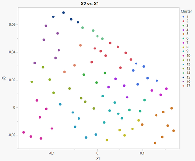

So I tried a more simple way, without the condition 5 samples/cluster, to sample some experiments evenly in the X1-X2 covariates experimental space using the Fast Flexible algorithm:
  1. Open the Space-Filling Designs platform.
  2. In the red triangle, click on "Load design" and choose your X1 and X2 covariates.
  3. Specify a number of runs equal to 85 and click on Fast Flexible Design.
  4. Once the design is created, use Join tables to get the cluster number of the selected samples in the design.
You'll get a good coverage of your covariate space but with a different sampling than you imagined:
Number of samples per cluster goes from 3 to 9, so it could be acceptable depending on your objectives.

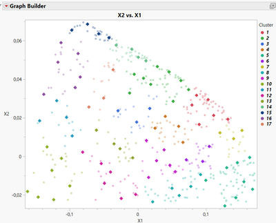

Here is how the selected points (diamonds) look like on the original full covariate set:
Please find attached the design created.

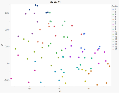

@frankderuyck I also thought about using Hard to change factors to have exactly 5 samples per cluster, but since X1-X2 coordinates are directly linked to the clusters and in the same covariate table, you'll have either all or none of the covariate factors as "Hard to change", which will prevent from having the kind of hierarchical structure you wanted to create (5 samples per cluster, and good repartition of X1-X2 coordinates inside each cluster). With covariate factors as hard to change factors, you'll get 5 times one sample per cluster.
Using the Custom design platform, simply selecting the covariate factors and entering them as "Easy to change", setting a main effects + interactions model with a run size of 85 allow you to get a design close to your needs:
  • 85 runs in total
  • 4 to 6 samples per cluster
  • All 17 clusters are present in the design
Repartition of the runs in the experimental space is less homogeneous compared to space filling design:
Please find attached this other option.
