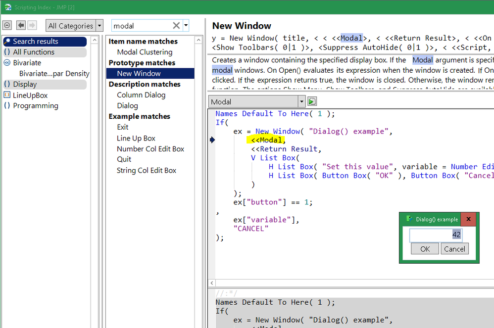

for modal, just change the example:
ex = New Window( "Dialog() example",
	<<Modal,
	<<Return Result,
	V List Box( H List Box( "Set this value", variable = text Edit Box( "Change this text" ) ), H List Box( Button Box( "OK" ), Button Box( "Cancel" ) ) )
// because the window is modal, the window must be closed before the following code runs If( ex["button"] == 1, // not canceled // then show the value write(ex["variable"] ), // note: variable is the name of the variable holding the text edit box
// else report no selection write("CANCEL"); // cancel button or red X was pressed );
The example in the scripting index needs a small rewrite to be more useful. I've fixed the main problem and added comments above. The main problem is the if-clause in the example is a confusing double-statement with a semicolon.

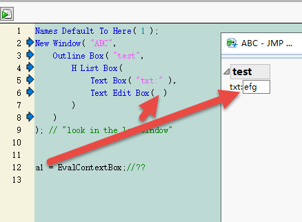

  • How can variable "a1" get the "efg" I filled in?
Thanks Experts!
Craige_Hales
Re: How to make JSL pop up a dialog box and wait for the user to fill in the parameters?
	<<Modal,
	<<Return Result,
edit: repair formatting (for some reason, the code formatter wants to mess up the final else statement)
Craige

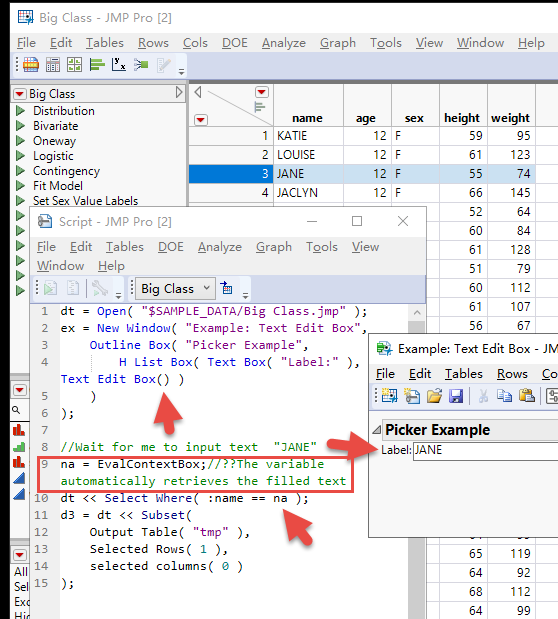

How can make this complete operation possible?
Thanks Experts!
ex = New Window( "Example: Text Edit Box",
	Outline Box( "Picker Example",
		H List Box( Text Box( "Label:" ), Text Edit Box() )
//Wait for me to input text  "JANE"
na = EvalContextBox;//??The variable automatically retrieves the filled text
dt << Select Where( :name == na );
d3 = dt << Subset(
	Output Table( "tmp" ),
	Selected Rows( 1 ),
	selected columns( 0 )
Here's a working example.  You need to include << modal, assign a variable to the text edit box, and retrieve the text edit box value before the user exits the modal dialog.
ex = New Window( "Example: Text Edit Box", << modal,
	panel Box( "Picker Example",
		H List Box(
			teb = Text Edit Box() ) ),
	panel box("Options",
		h list box(
			ok_button = button box("OK", na = teb << get text),
			canc_button = button box("Cancel", na = "")
show(na);
// Wait for me to input text  "JANE"
dt << Select Where( :name == uppercase(na) );
d3 = dt << Subset( Output Table( "tmp" ), Selected Rows( 1 ), selected columns( 0 ) );
Craige_Hales
There are two competing approaches.
@pmroz  example shows one way to use a <<modal dialog.  The JSL callback function on the OK button copies values from the dialog into global variables.
Several answers above, I used the <<ReturnResult approach.  <<ReturnResult captures values of named display boxes. The results are returned in a list.
Craige
