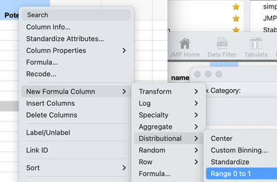

Re: How to lower the plateau of a 4 parameters fit curve?
another option is to scale your response variable 0-1.
