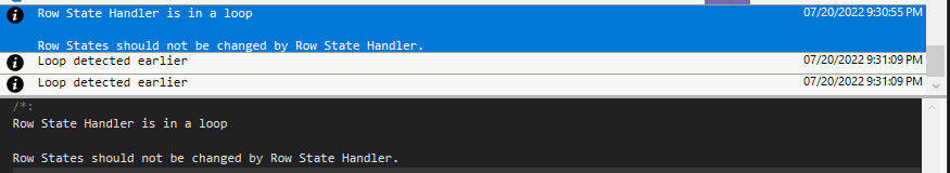

jthi
Re: How to link graph selections with JSL?
Managed, at some point, to generate "helpful" message in Enhanced Log
-Jarmo

jthi
Row State Handlers trigger on all row state changes. So when you choose 1 row, you trigger (at least) two events; one deselect and one select. Most likely this is causing some issues and could very easily cause loop. If you could only capture specific events (select, un-select, hide, exclude...) maybe it would work.
-Jarmo
