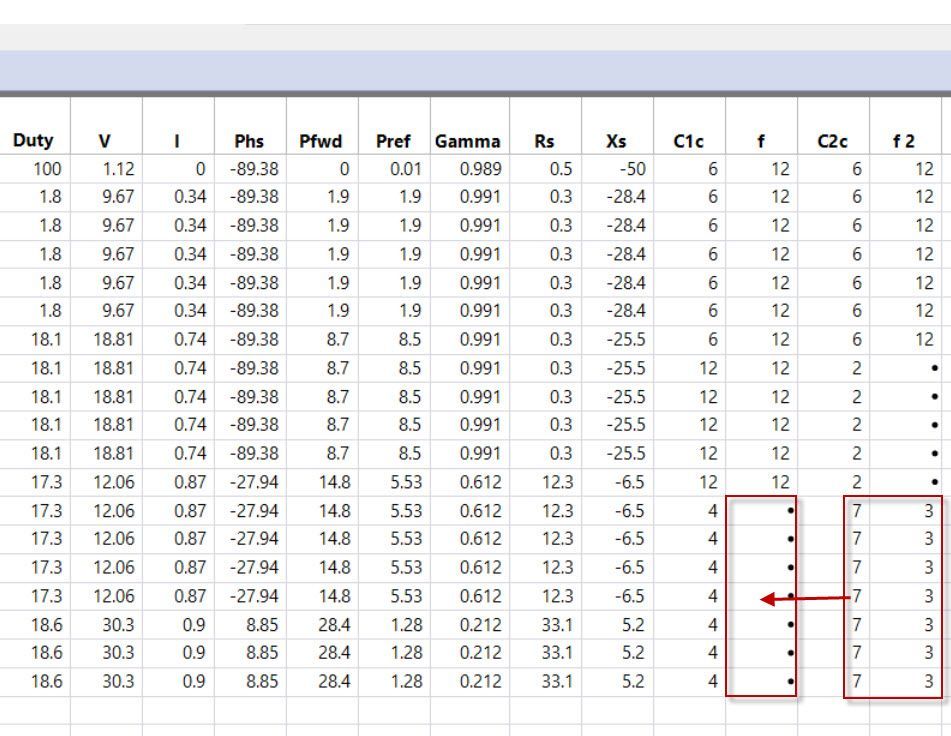

How to line up each field?
I have txt file. I would like to import to JMP to analysis. But some columns are not line up. How do I line up them?
The delimited should be space, spaces and comma. But ", " will treat space as text. How do I overcome this problem?

Re: How to line up each field?
The issue you are having is that you are using spaces and commas for delimiters, and in column f you have rows that have both a comma and a space delimiter side by side.  An example is
4, 7
The column C1c reads in the 4, it then sees the , as a delimiter followed by a space as a second delimiter so since it did not see a value after the first delimiter and the second delimiter, it applies a missing value to the column f, and the 7 then becomes the value for the column C2c.

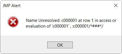

Victor3
Level II
Okay, I see. I understand your suggestion. But it give me above alert.
Victor Huang
Victor3
Level II
	For Each( {col},
		dt << Get Column Reference( dt << Get Column Names( Character ) ),
		If( !Is Empty( col << Get Formula ),
			Continue()
		For Each Row( dt, col[] = Substitute( col[], ",", " ", <<IGNORECASE ) );
I replace that line with these code. It's working now. Thanks.
