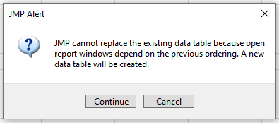

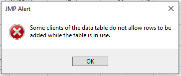

Did your script crash or did you get stuck by error messages like

Sort data table + add rows + concatenate -> make it possible
with a inked subset:
sort → no
add rows → no
concatenate → no
with an open report:
sort → no
add rows → yes (!)
concatenate → yes (!)
with a linked summary tables:
sort → no [why does SORT not "cut the link"?!?]
add rows → yes²
concatenate → yes²
² JMP automatically cuts the link:
