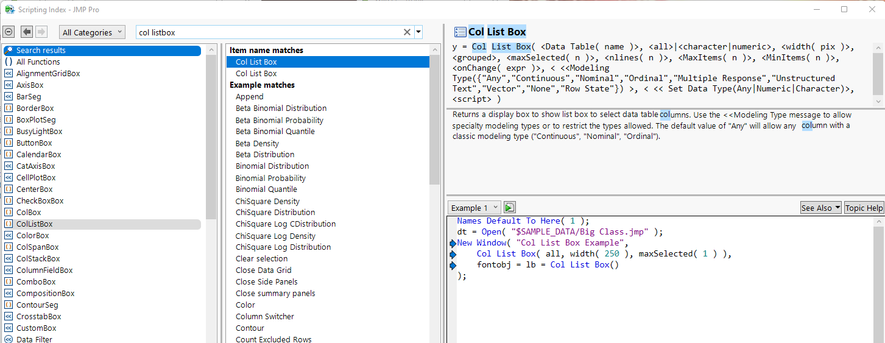

The Col List Box() display object is probably the best item to use to request input from a user on what columns to process.  Here is the entry from the Scripting Index

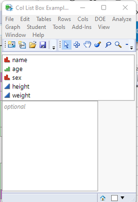

The example creates a display window that allows for the selection of columns from the data table
From there, you can add instructions and also collect the selected columns to be processed
