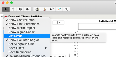

 Make a control charts in Control Chart Builder
Use get limits to get the control lists.
Use Save Limits to save the limits to the column property
There are several other ways to do this.

I try to select get limit but nothing happened. Any idea why ?
