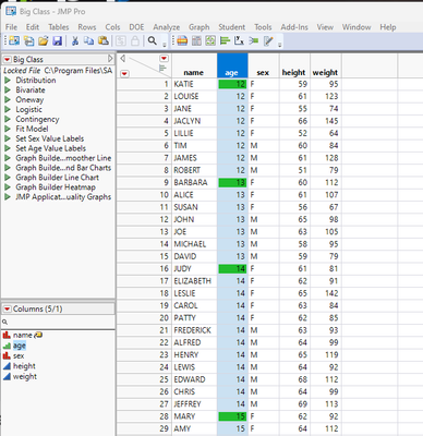

  1. Use Select Duplicate Rows
    1. Select the target column you want to see the change in
    2. Click on the red triangle located at the top of the Row Stat(Row Number) column, and select
      1. Row Selection=>Select Duplicate Rows
      2. All rows, except the first row for each new value of your target column will be selected.  This may work perfectly for you,                                                                                                txnelson_0-1697850286139.png
        but is you want only the first row for each group selected, and the none of the secondary rows selected, you can Invert the Row Selection
        1. Go back to the red triangle and select
        2. Row Selection=>Invert Row Selection

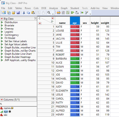

2. You can use the Column Property to set the color values for each different value of the target column, and when you do that, you can specify to "Color the Cell by Value"
