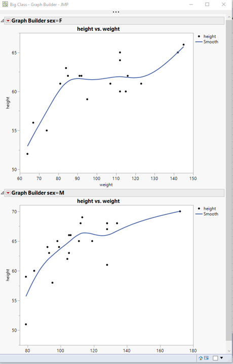

I would like to know how to display graphs horizontally when using a By variable with the graph Builder?
Here is a small example script:
Graph Builder(
Size( 528, 456 ),
Show Control Panel( 0 ),
Variables( X( :weight ), Y( :height ) ),
Elements( Points( X, Y, Legend( 1 ) ), Smoother( X, Y, Legend( 2 ) ) ),
By( :sex )
I get the following result:

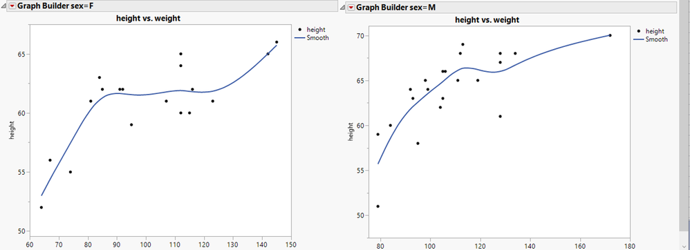

And I would like to get this:
Any idea of how we could do that?
Thanks in advance!

Try this approach:
Names Default to Here( 1 );
New Window( "Side by Side",
	Line Up Box( N Col( 2 ),
		dt << Graph Builder(
			Size( 534, 456 ),
			Variables( X( :height ), Y( :weight ) ),
			Elements( Points( X, Y, Legend( 3 ) ), Smoother( X, Y, Legend( 4 ) ) ),
			By( :sex )
2 REPLIES 2

anne_sa
Level VI
Re: How to have an horizontal layout when using a By variable with the graph builder?
Thanks @Mark_Bailey that's exactly what I was looking for!!
