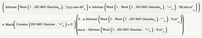

So, if you want to convert everything back to GMT you'll need to take the offset into account:
Informat( Word( 1, :ISO 8601 Datetime ), "yyyy-mm-dd" )
+Informat( Word( 1, Word( 2, :ISO 8601 Datetime ), "-+" ), "hh:mm:ss" )
+Match( Contains( :ISO 8601 Datetime, "+" ) > 0,
	0, Informat( Word( 2, Word( 2, :ISO 8601 Datetime ), "-" ), "h:m" ),
	-Informat( Word( 2, :ISO 8601 Datetime, "+" ), "h:m" )
It may be easier to read in the Formula Editor where you'll want to use this anyway:

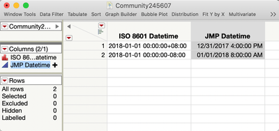

I'm attaching a data table with an example with the formula column.
-Jeff

Also: test any code that manipulates times carefully. I had to study Jeff's formula to understand the match...contains...0... stuff, and it might be correct (or the sign might be reversed).
https://en.wikipedia.org/wiki/ISO_8601
I'm in zone -5 ("five hours behind UTC"). I'm pretty sure I have to add 5 (or subtract -5) to my time to get UTC. I think the "+match(" should be "-match(".

Yes, @Craige_Hales, you're right. I did mess up the sign. I've corrected in my post above.
