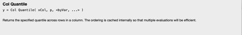

You can use the quantile function without and with a by variable as shown in the example below.
Names Default To Here( 1 );
Open( "$SAMPLE_DATA/Big Class.jmp" );
Row() = 1;
median_ht = Col Quantile( :height, 0.5 );
Row() = 1;
median_htbyage = Col Quantile( :height, 0.5, :age );
Show( median_ht ); //Show median height
Show( median_htbyage ); //Show median height by age
Col Median FunctionCol Median Function

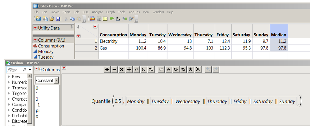

Indeed I was looking for a median of a matrix because I was not able to extract it immediatly from the table, but may be you can lead me to a way:
I hava a table (like below). I would like to calculate the median of each row in a simple way. Of course I need to exclude the 1st column from the calculation. In excel it is straight forward, but in JSL-JMP, I do not know how to do it simply (avoiding to stack the table,...).
Example of a table:
Consumption   Monday  Tuesday  Wednesday  Thursday  Friday  Saturday  Sunday  Median
Electricity         11.2        10.4         13.0              7.1            12.4     11.9         9.7         ?
Gas                  100.4      86.9         94.8              103.0        112.3    95.3        97.8       ?

Using Stan's quantile method, add the formula to the median column:
New Table( "Utility Data",
	New Column( "Consumption", Character, "Nominal", Set Values( {"Electricity", "Gas"} ) ),
	New Column( "Monday", Numeric, "Continuous", Format( "Best", 12 ), Set Values( [11.2, 100.4] ) ),
	New Column( "Tuesday", Numeric, "Continuous", Format( "Best", 12 ), Set Values( [10.4, 86.9] ) ),
	New Column( "Wednesday", Numeric, "Continuous", Format( "Best", 12 ), Set Values( [13, 94.8] ) ),
	New Column( "Thursday", Numeric, "Continuous", Format( "Best", 12 ), Set Values( [7.1, 103] ) ),
	New Column( "Friday", Numeric, "Continuous", Format( "Best", 12 ), Set Values( [12.4, 112.3] ) ),
	New Column( "Saturday", Numeric, "Continuous", Format( "Best", 12 ), Set Values( [11.9, 95.3] ) ),
	New Column( "Sunday", Numeric, "Continuous", Format( "Best", 12 ), Set Values( [9.7, 97.8] ) ),
	New Column( "Median", Numeric, "Continuous", Format( "Best", 12 ),
	// the 2nd argument to the quantile function is a matrix made from the days of the row...
		formula( Quantile( 0.5, monday || tuesday || wednesday || thursday || friday || saturday || sunday ) )
column formula using Quantile to get Mediancolumn formula using Quantile to get Median
