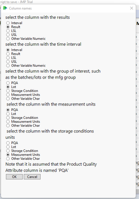

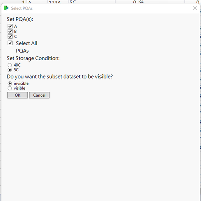

Hello,
I have been creating an application that involves the user to select columns to use in building a model, for select PQAs, through the use of modal windows, as in the attached JMP file with the toy data and script titled "Model for Select PQAs and Columns".
This model is supposed to create custom output for each PQA selected for any dataset with any spelling of column names. Which the script is run, a pop-up comes up asking the user to select specific columns. This window is shown in the figure below:
The next window asks the user to set the PQAs, storage condition, and asks if the user wants to view the subset dataset for each PQA - storage condition or not. That is, for each PQA selected, a subset dataset is created in the background. Then, model and graph results are produced and then appended at each iteration of the for loop to a window with the customized and formatted data (with the LSL and USL y-axis lines and y-axis labels with measurements).
Here is the JSL script code that produces the output given the user input from the windows mentioned above:

nw1 = New Window("Column names",
	<<Modal,
	Text Box ("select the column with the results"),
	result_col = Radio Box(numeric_col_names),
	Text Box ("select the column with the time interval"),
	time_col = Radio Box(numeric_col_names),
	Text Box ("select the column with the group of interest, such as the batches/lots or the mfg group"),
	groupby_col = Radio Box(character_col_names),
	Text Box (" select the column with the measurement units"),
	units_col = Radio Box(character_col_names),
	Text Box (" select the column with the storage conditions units"),
	storage_condition_col = Radio Box(character_col_names),
	Text Box ("Note that it is assumed that the Product Quality Attribute column is named 'PQA'"),
	H List Box(
		Button Box("OK",
		answers = Eval List(
			set_resultcol = result_col << get selected,
			set_time = time_col << get selected,
			set_groupby = groupby_col << get selected,
			set_units_col = units_col << get selected,
			set_storage_condition_col = storage_condition_col << get selected
	nw1 << close window;
	Button Box("Cancel")
	//change popup window size
	<<Size Window(500,700)
// If cancel or red X was clicked, stop the script
If( nw1 == {Button( -1 )}, Stop() );
//Part 2: Select PQA(s), storage condition, and other options.
//Get the unique storage conditions
col_stor_cond = Column(dt, set_storage_condition_col);
unique_stor_cond = Associative Array(col_stor_cond) << get keys;
invisible_window_options = {"invisible", "visible"};
nw2 = New Window( "Select PQAs",
					<<Modal,
					Text Box("Set PQA(s):"),
					variablebox1_pqa = Check Box( unique_pqa ),
										H List Box(
											variablebox1_pqa_all = Check Box(
												<<SetFunction(
													function({this},
														variablebox1_pqa << Set All( this << Get, run script( 1 ) )
											Text Box(
												"Select All PQAs",
												<<Set Width( 90 ),
												<<Set Wrap( 90 )
					Text Box("Set Storage Condition:"),
					variablebox2_stor_cond = Radio Box( unique_stor_cond ),
					Text Box( "Do you want the subset dataset to be visible?"),
					variablebox1_subset_visibility = Radio Box( invisible_window_options ),
					H List Box(
					//get all saved variable values when the user
					//selects the OK button from the menu
						Button Box( "OK",
							answers = Eval List({
							selected_pqa = variablebox1_pqa << get selected,
							selected_stor_cond = variablebox2_stor_cond << get selected,
							selected_visibility = variablebox1_subset_visibility << get selected
							nw << close window;
						Button Box( "Cancel")
					<<Size Window(600,600)
If( nw2 == {Button( -1 )}, Stop() );

With my output window created, I want to be able to save the script to the original data table with all data in it (that the subset data is dependent on). However, when I save the scripts for all output to script window, I get the following results:
Notice the
Where ( :PQA == pqa_val & column(listDT, set_storage_condition_col) == selected_stor_cond )
 statement does not allow the script to work.
I want this statement in this script to have the particular output. For example, in the toy dataset I have attached, the
is equal to :Storage Condition
Additionally, if I were to select A as the pqa_val ( so that :PQA == "A" ) and 5C as the selected_stor_cond (so that :Storage Condition == "5C").
However, the output script produced would not be existent, even though I am referring to the user input. Why isn't JMP writing these values as in this example above into the script for each particular instance in the loop?
	<<Modal,
	Text Box("select the column with the results"),
	Text Box("select the column with the time interval"),
	Text Box("select the column with the group of interest, such as the batches/lots or the mfg group"),
	Text Box(" select the column with the measurement units"),
	Text Box(" select the column with the storage conditions units"),
	Text Box("Note that it is assumed that the Product Quality Attribute column is named 'PQA'"),
	H List Box(
		Button Box("OK",
				{set_resultcol = result_col << get selected, set_time = time_col << get selected, set_groupby = groupby_col << get selected,
				set_units_col = units_col << get selected, set_storage_condition_col = storage_condition_col << get selected}
	<<Size Window(500, 700)

nw2 = New Window("Select PQAs",
	<<Modal,
	variablebox1_pqa = Check Box(unique_pqa),
	H List Box(
		variablebox1_pqa_all = Check Box(" ", <<SetFunction(Function({this}, variablebox1_pqa << Set All(this << Get, run script(1))))),
		Text Box("Select All PQAs", <<Set Width(90), <<Set Wrap(90))
	variablebox2_stor_cond = Radio Box(unique_stor_cond),
	Text Box("Do you want the subset dataset to be visible?"),
	variablebox1_subset_visibility = Radio Box(invisible_window_options),
	H List Box(
		Button Box("OK",
				{selected_pqa = variablebox1_pqa << get selected, selected_stor_cond = variablebox2_stor_cond << get selected, selected_visibility =
				variablebox1_subset_visibility << get selected}
	<<Size Window(600, 600)
If(nw2 == {Button(-1)},
	Stop()
	<<Modal,
	H List Box(
	H List Box(
		Button Box("OK",
