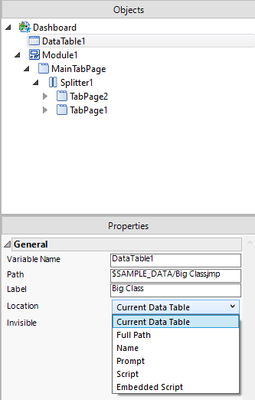

I have found a solution myself,
In dashboard properties, selected the data table source as "Current data table" rather than embedded script.
So the formula column generated in data table with script in current data table can be used in dashboard.

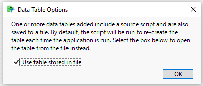

As the table is not saved yet, the Dashboard decides to use the source script of the data table to generate a new one
- and fails, as the source script doesn't generate the new column.
There are several ways to escape the trap:
  1. add the generation of the additional column to the source script before you generate the Dashboard
  2. save the data table before you generate the Dashboard.
    Then an additional window opens and ask if it should use the source script or instead use the stored info. -> take the second option by selecting

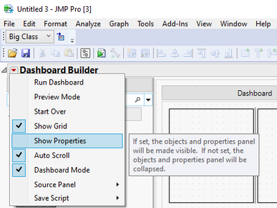

Re: How to get formula column included in dashboard building using scripting
In Dashboard Builder the property panel is closed by default.  The easiest way to open and close the property panel is from the red-triangle menu:
From the property panel you can then change the initial settings for the Data Table Location:
