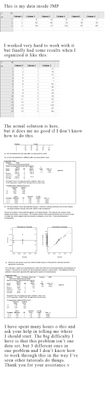

I attached a picture that illustrates my question.
I'm having trouble working with a data set that consists of results for 3 different methods of doing the same thing.
I have watched many tutorials but I can't apply them effectively to my problem. I'm sure it's just one thing that is obvious to someone who is experienced, and I hope you can put me on the right track with some good search keywords, etc, so I can find the answer.

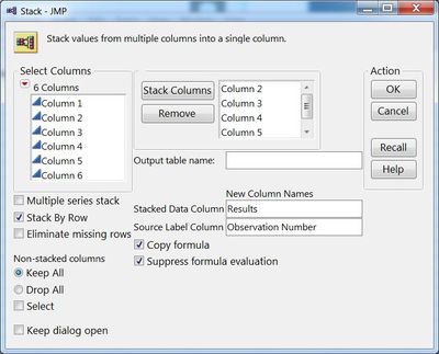

You have had a good start. JMP, like most statistical packages will require you to have your data organized properly first. That is, each column is a variable, each row is an observation. Therefore, you can use the Stack Columns feature in JMP to quickly arrange the data properly. Here is what the dialog box looks like for the Stack command:

However, I did notice something peculiar with your data. The analysis that you included does NOT match the data that you provided. Specifically, look at method 3. The average for method 3 should be 74, but the analysis output that you provided says 73. That could be why you are not getting the results to match. Your captured analysis was not done on the data that you have.

Not sure what you mean with three data sets, but In JMP a vertical data set is often assumed. So you did the right thing to transform the data table the way you did (Stack in the Tables menu is great for converting a wide table into a tall one).
To get a detailed ANOVA report, the Fit Model platform found in the Analyze menu is the way to go. But first make sure the data type of your categorical factor (i.e. Column 2) is set to Nominal.
In the Fit Model launcher set Column 3 as Y and add Column 2 to the Model Effects. If a transformation is requested, select the variable and choose an adequate transformation from the Transform red-triangle menu. Click run.
