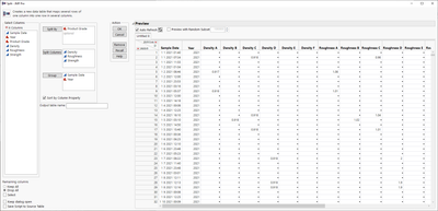

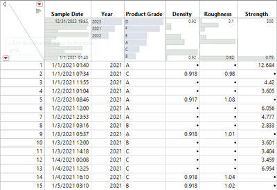

I have the data table set-up as attached where my end goal is to generate the cpk/ppk values for each grade based on numerous quality (in this case density, roughness and strength) and also generate the process capability box plots.
I am able to generate those in 'process screening' however unable to do the same using process capability platform in the 'analyze' section. I've successfully done it previously however there were multiple additional steps needed to get there (i.e create subsets and split the table first) which to me is inefficient if I have > 10 grades and > 10 qualities to be analyzed.
Just by using the existing data table format that I have right now and the spec limits table, is there a way for me to get the same result?

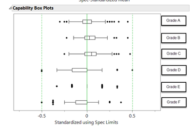

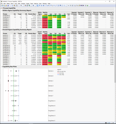

Capability box plots that I wanted (example for roughness):

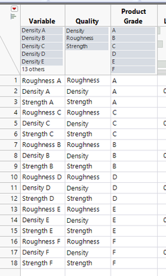

You need to have Variable column in your Spec Limits table (Combine Quality and Product Grade in this order)
Formula:
:Quality || " " || :Product Grade
Then you have to split your data

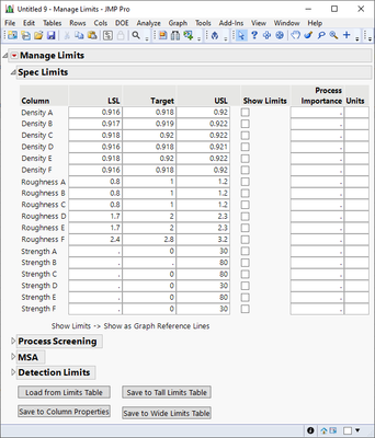

After that go to Manage Limits (I think JMP17.2 isn't able to capture this part properly) and Load from limits table and save to column properties
after this you can run Process Capability

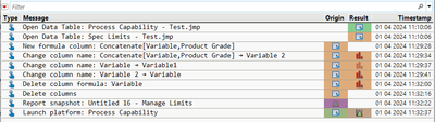

Table attached with table script to re-create process capability. Workflow is also attached but it doesn't work due to the issues with Manage Limits

I don't think you can do it easily with your exact data format. If you have been able to do it previously, you could maybe create a workflow or get the script from Enhanced Log to reproduce your steps. Doing this doesn't really require too many steps BUT it does require some modifications to your data (split your results, add new column to specs and remove few other columns, set spec limits and run the platform)
Other option could be to calculate your Cpk/Ppk using Process Screening and then use Graph Builder to create those boxplots but this would still require you to modify how your data is formatted.
Formula:

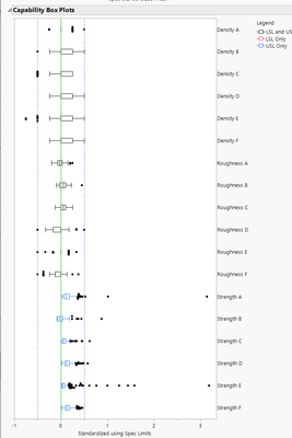

Re: How to generate capability box plots for multiple process qualities?
I tried out this method and very satisfied with the outcome. The manage limits function works on my JMP Pro too.
