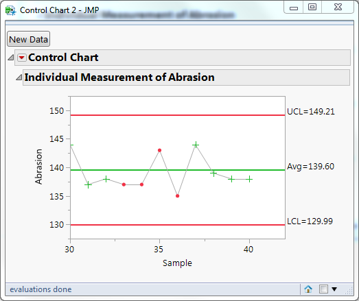

I copied Bryon's control chart code into yours, added a random 'min' time, and here is what I see:
//Open a window to show a control chart and then update
//the chart every 15 seconds
//Includes a button to refresh early.
Names Default To Here( 1 );
//Define variables here that need to keep their values through subsequent function calls
//This includes the window and data table
//Open a window to hold the chart (note this only happens once)
nw = New Window( "Control Chart",
	V List Box(
		Button Box( "New Data", UpdateData() ),
		holder = H List Box();
//Make a variable to hold a reference to the data table
dt = .;
//A function that will update the chart
UpdateData = Function( {},
	//Close the table if it is already open
	Try( dt << Close Window );
	//Open data table
	dt = Open( "$SAMPLE_DATA/Abrasion.jmp", Private );
	//Make the control chart
	obj = dt << Control Chart(
		Group Size( 1 ),
		KSigma( 3 ),
		Chart Col( :Abrasion, Individual Measurement ),
		SendToReport(
			Dispatch(
				{"Individual Measurement of Abrasion"},
				"1",
				ScaleBox,
				{Min( nrows() - Floor( Random Uniform( 10, 25 ) ) ), Max( nrows() + 2 ), Inc( 5 ),
				Minor Ticks( 1 )}
	//Hide the temporary control chart window
	obj << ShowWindow( 0 );
	//Remove existing/old graph from the window (if there is one)
	Try( (holder << Child) << Delete );
	//Add the new graph
	holder << Append( (H List Box( (obj << Report) << Clone Box )) );
	//Close the temporary control chart
	obj << Close Window;
//Script to update then chart and then call itself 15 seconds later
quickieScript = Expr(
	//Load the chart in the window (run the script in the function)
	UpdateData();
	//Run this same script in 5 seconds
	Schedule( 5, quickieScript );
//Start things off:
quickieScript;
AT
