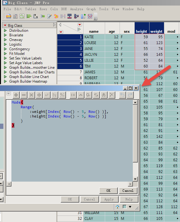

For example, add new columns with "Big Class. JMP ", and find the mode of the data in the same row of the "height"、"weight" columns and the five rows above.
Thanks!
mode(Range(:weight[Index(Row()-5,Row())], :height[Index(Row()-5,Row())]))

Here is the formula that I came up with
If( Row() > 6,
	Mode( Matrix( :height[Index( Row() - 5, Row() )] ) || Matrix( :weight[Index( Row() - 5, Row() )] ) ),
	Mode( Matrix( :height[Index( 1, Row() )] ) || Matrix( :weight[Index( 1, Row() )] ) )
Note: The Range() function returns the minimum and maximum values found in the list or matrix
Note: JMP returns the minimum mode value if there is more than one mode

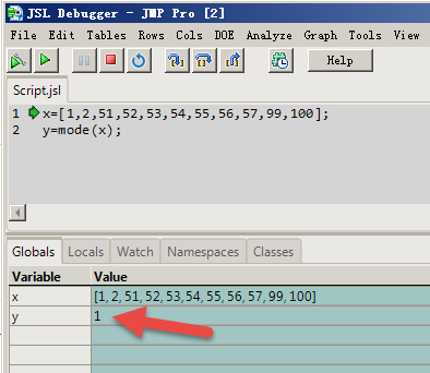

The JMP mode formula seems rather lax.
In Excel, no mode is returned as "#N/A", and JMP is returned as "minimum".
txnelson
Re: How to find the mode of multiple columns and partial rows?
The minimum is a correct mode.  There just happens to be more than one mode.
Jim
