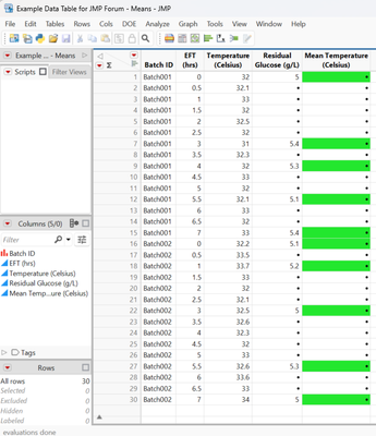

I'm running into this issue where I have two sets of datapoints across my timeline. One is collected at every point in the interval "Temperature (Celsius)", the other is collected sporadically "Residual Glucose (g/L)". When placed together in a data table, one of the columns is missing data in the interval. I attached a data table as an example but essentially looks like this:
What I need is to get the mean of the "Temperature (Celsius)" column between rows that contain data in the "Residual Glucose (g/L)" column. The caveat is that this has to be forward-looking . E.g. at row 1, the result should just be "32".  At row 7, the result should be the mean of everything in [Row 2, Row 7] = "32.1". The results should show in the cells highlighted green.
I have been doing this by creating a helper column, using sort, and then tabulating but this is very time consuming. I am hoping to get help automating this as I keep adding data to my table. I would appreciate any help and/or guidance!

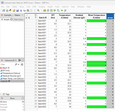

txnelson
Re: How to find the mean between rows by a group with missing data in a forward-looking format?
You can create a new column that adds a grouping column that has different group values for each of the non Residual Gluecose value rows.
Here is the formula for the calculation of the group variable
As Constant( x = 0 );
If( Is Missing( :"Residual Glucose (g/L)"n ) == 0,
	x
If( Is Missing( :"Residual Glucose (g/L)"n ) == 1,
	x
Then using Col Mean you can get the means you want
Here is the formula for the group mean calculation
If( Is Missing( :group ) == 0,
	Col Mean( :"Temperature (Celsius)"n, :group )
Jim
