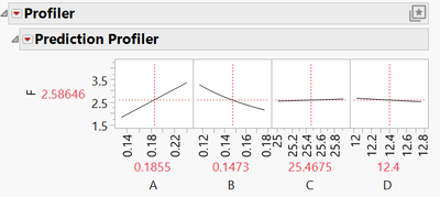

Regardless of the formula, once you have it entered into a JMP table, then you can use Graph > Profiler. Put the formula column in the Prediction Formula spot.  Here is an example based on the original equation.

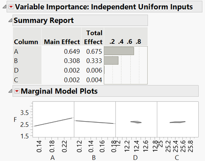

This shows that A and B are the most important. But what is the actual ordering? We can get that by using a simulation. Click on the Prediciton Profiler red triangle and choose Assess Variable Importance > Independent Uniform Inputs (or one of the choices that best fits your situation -- read the JMP manual to read descriptions of all of them).
This report shows the rank ordering of the factors. I think this may be a good way for you to assess the factor importance. However, please keep in mind that there are limitations to this approach and several assumptions that are being made. Be sure to read all of the information in the JMP manuals to understand the approach.

Thank you for the detailed explanation! As Dan mentioned, my question leans more towards a mathematical approach, focusing on the properties of the formula rather than a statistical analysis. My primary goal is to evaluate the individual contribution of each variable in the formula and understand how changes in each one influence the volatility of Index F.
I believe Dan's suggestion regarding effectiveness assessment will be an excellent tool for addressing this objective, and I look forward to using it in my work.
