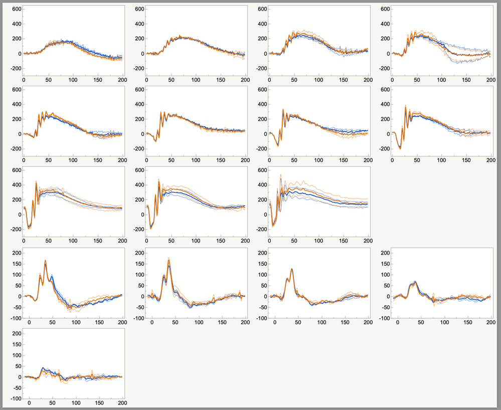

I'm a JMP novice using JMP 16.0.0 on a Mac.  I'm trying to write a script that will open and rearrange .txt files generated by an electroretinography instrument and its software. The files include repeated time series (time and voltage values) in columns, which I stack and plot in JMP 16.0.0 using the Lineup Box feature. Currently I generate two Lineup Box windows (see attachment). In the final step, I'd like to be able to use JSL to export the multigraph windows to a pdf as I can in JMP, but I have been unable to find a way to do this.  Ideally, both windows would be merged in one pdf document.

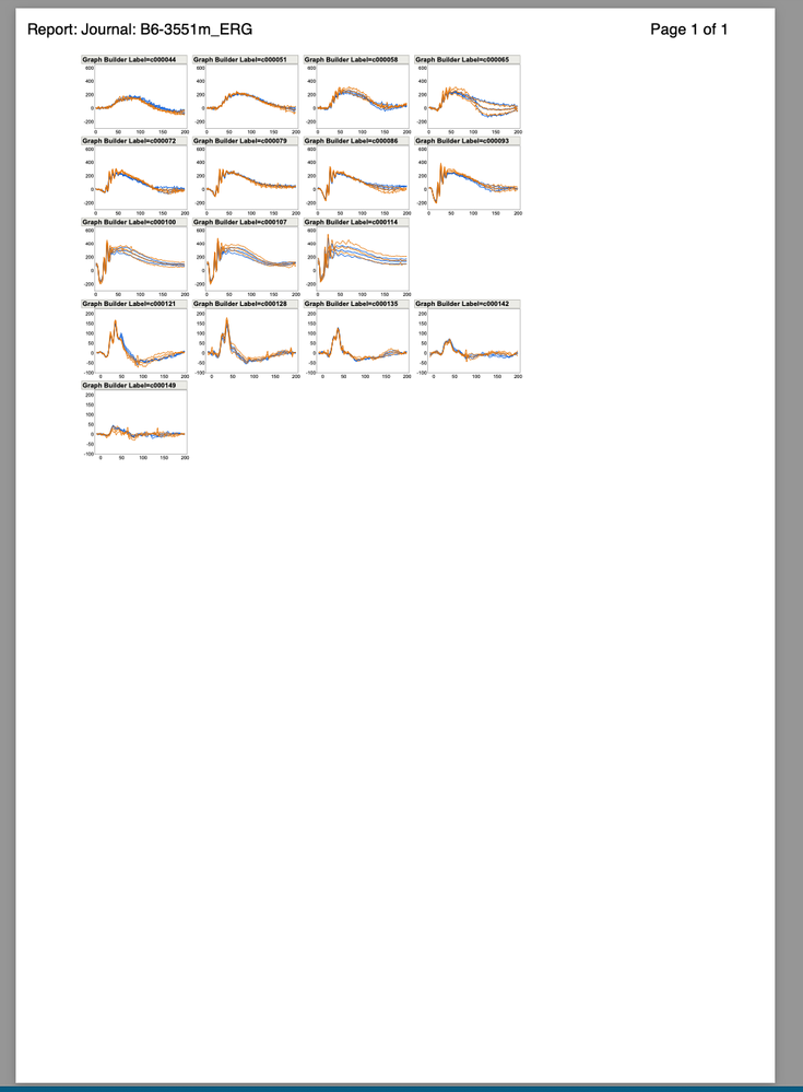

Although your suggestion to "Throw your whole lineup box in a journal" was initially frightening to a newbie, I cast about the web for syntax, and at the top of the script added a new journal window with:
new window(sample||"_ERG", <<journal);
and then followed each section of code that created a Lineup Box window with:
current report()<<journal;
At the end of the script I adjusted your code to match my window names:
jrn = current journal();
jrn << Set page setup( margins( 0.5, 0.5, 0.5, 0.5 ), scale( 0.4 ), portrait( 1 ), paper size( "A4" ) );
jrn << Save PDF( sample||"_ERG.pdf" );
This worked almost perfectly!  I've attached screenshots (pardon the resolution) of the JSL saved .pdf (first attachment) and of the journal window manually exported as a pdf from JMP (second attachment).  If possible I'd like to scrub the "Graph Builder" control headers from the JSL output (as in the JMP output) and enlarge the plots a bit, but other than that you provided the solution I was looking for.  Thanks very much.
